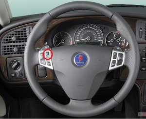

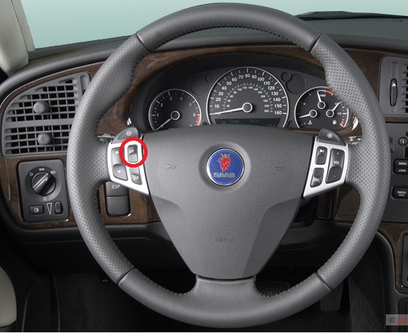

Re: 1.9TiD zili dumi priekseja laba sparna rajona
mario wrote:Uz stures info pogas nav. Paneli uzstadijumos parakos, bet opciju "heater on" vai "heater off" neatradu. Tad jau laikma nav tas apkures.
Vai tiešām tev nav tās pogas, kas apvilkta ar sarkanu aplīti!? :think:

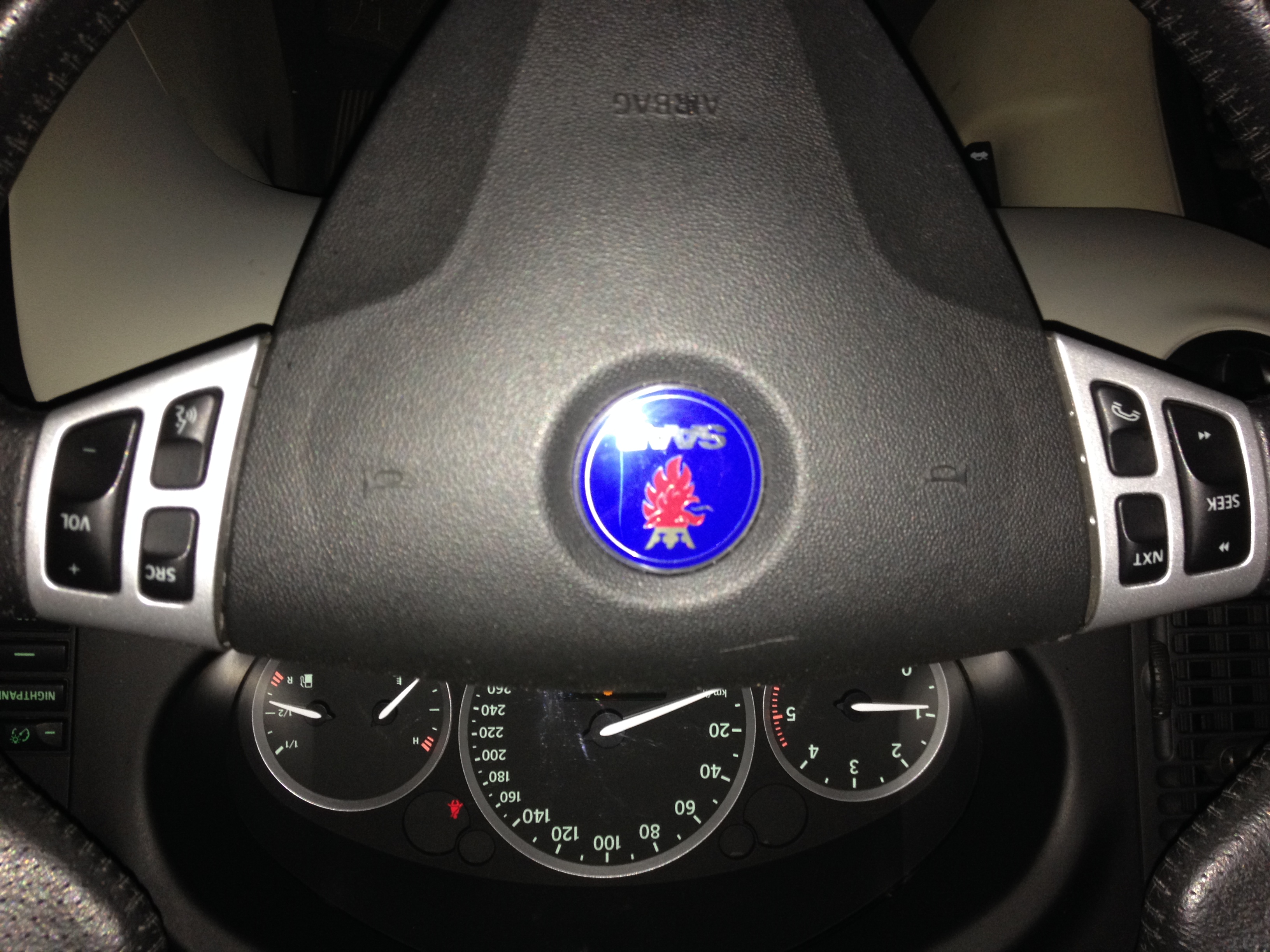

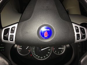

mario
Posts: 8
Joined: Wed Oct 15, 2014 12:13 am
Post by mario »
Precizi taja vieta uz stures ir poga "next" prieks audio.
